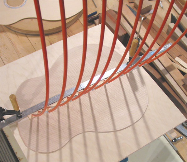

the way I do it...
Stewmac straight edge to keep it lined up. Go bar to protect the backgraft,
and go bars clamping it all down... Not so great detail picture.

I guess one good pic deserves another...
John Watkins

I do it a little different. I glue the braces in first, then shape them, I find it easier to use a plane to shape them if the center strip is not there. Once the braces are all shaped and sanded I piece in the center strip.

Hesh, does your back workboard also have a matching 15' radius?
